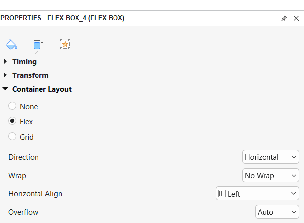

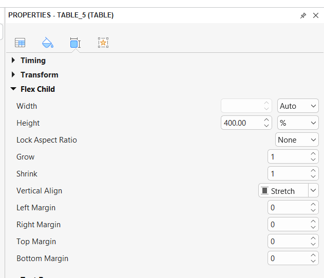

Hi @Rolf,
If you want the table to scroll the same way a website does, you can place it inside a flexbox container.
First, set a fixed height for the table.
Then, set the flexbox’s Overflow property to Auto.
This will allow the table content to scroll smoothly within the container.

Below are the detailed settings for the flexbox and container:
Set the width of each table to 100%, and set Wrap = Wrap in the Flex Container Layout.

Excellent, I thought the scrolling was a feature of the table, but, of course, it’s a feature of the flexbox …
