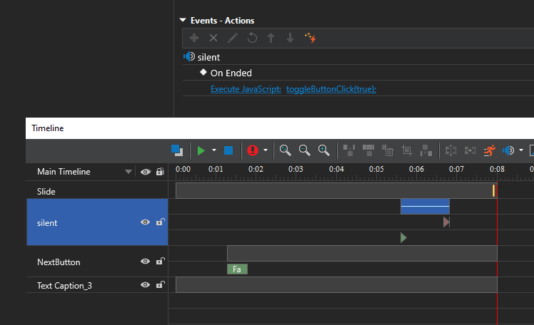

And on slides you can control when is next button allowed using scripts:
toggleButtonClick(false);
or
toggleButtonClick(true);
Put toggleButtonClick(false); to onload of slide
And then put toggleButtonClick(false); to end of the slide (you can use short silent sound and put the script to on ended event) like on picture:
Or You can put it on succes state of test or to another fulfilled state that you need
