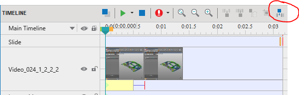

We see that the video duration in slide 5 is too short. That leads to your issue.
To solve it, you just need to add a short time at the beginning of the video using the Insert Time feature.

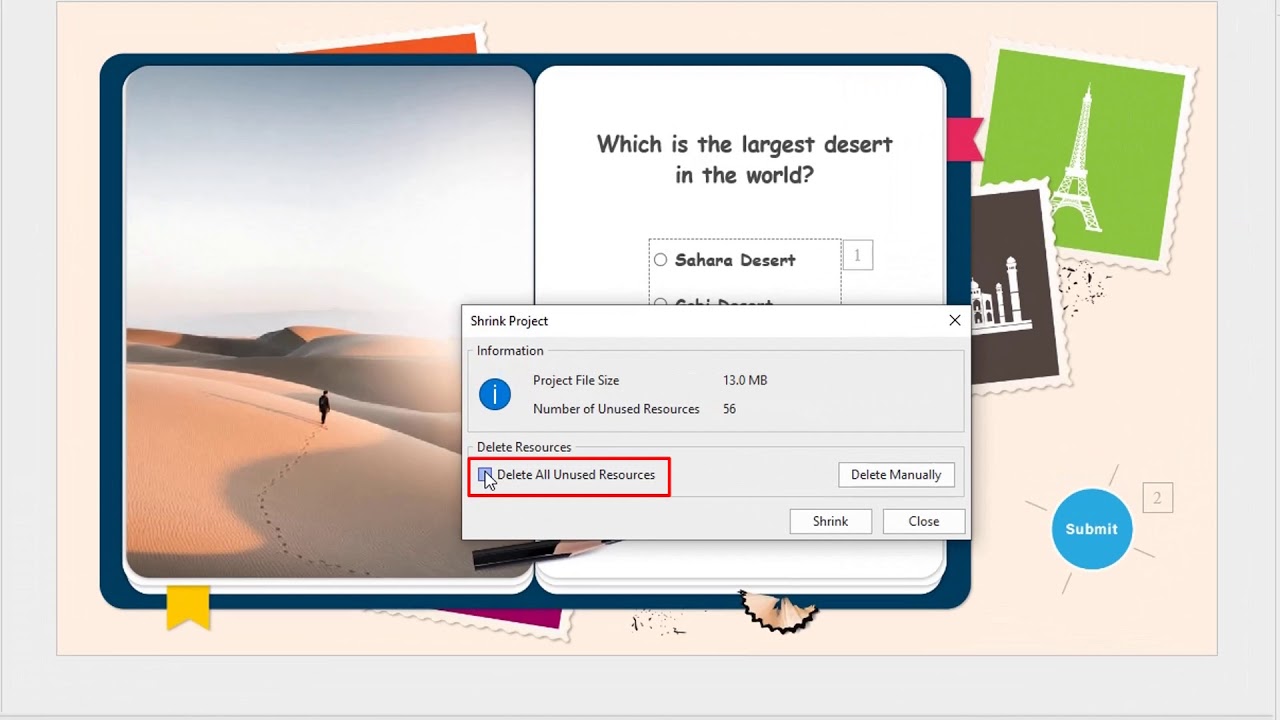

We also want to note that your project has many unused resources.
You can optimize your project by deleting them in the Resources pane or shrinking the project (ActivePresenter button > Project > Shrink…)
Please watch this quick tutorial video for details:
