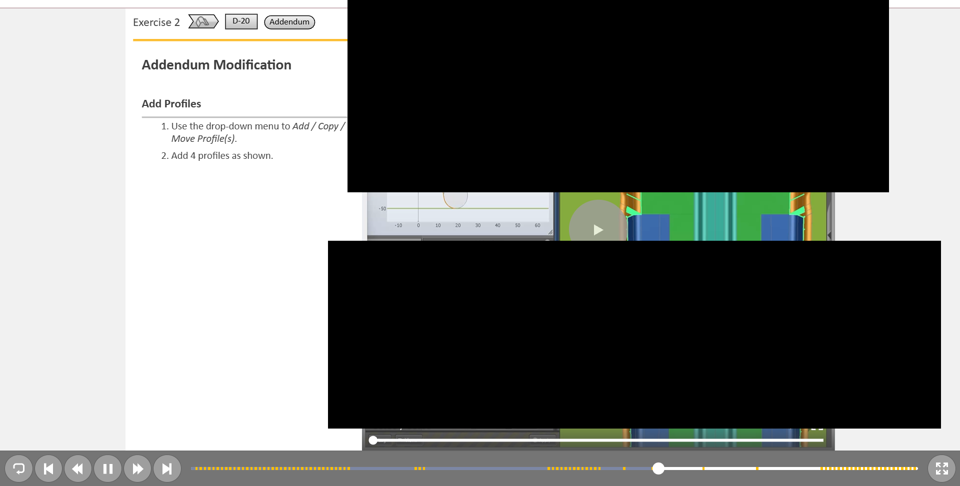

In the attached screenshot, you can see that two toolbars are displayed in the course:
  • one global toolbar for the overall presentation,
  • and a second toolbar dedicated to the embedded video.
Visually, this results in a layout that is not very clean, because both toolbars appear simultaneously.
At the moment, the only way to remove the video toolbar is to enable Autoplay. However, this is not ideal for learning purposes: we would prefer the learner to read the accompanying text first, and then manually click Play when they are ready—without having the full video toolbar visible.

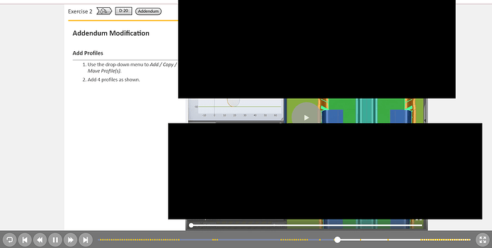

When using your method, the fixing dot continues moving in the global toolbar also while pressing on Pause. Is there a way to fix this ?
