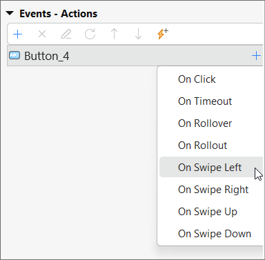

It seems that you’re referring to the swipe events here:
On Swipe Left/Right/Up/Down: Occur when users swipe across an object/a slide to the left/right/top/bottom on the touch screen. Available for slides, buttons, drop targets (not including drop areas), animated timers, text captions, shapes (including all message types), containers, equations, and images.
For more information on how to use events-actions in ActivePresenter, please check out this tutorial: How to Add Interactivity to Courses with Events-Actions in ActivePresenter 9

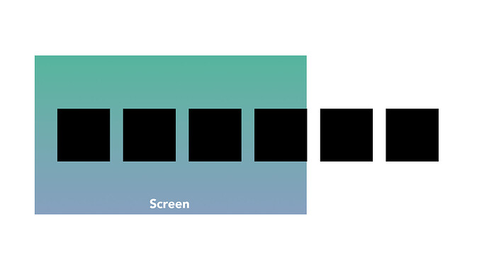

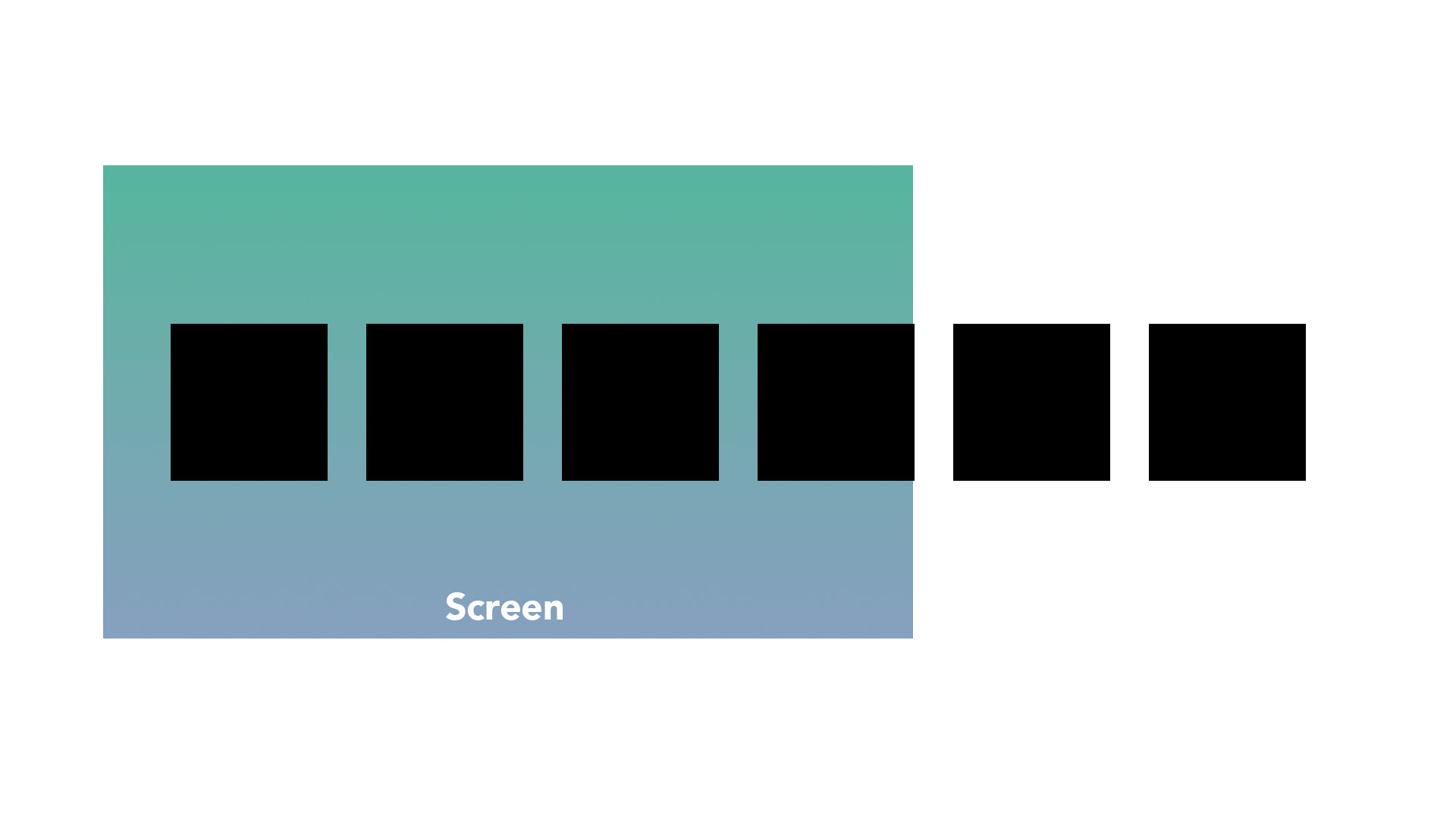

Thanks for the explanation. I did see these videos but they are not quite what Im looking for. In the example below I have a screen with 6 items in black on them. Can you use a gesture to slide the 6 black objects to the left so you can see the last couple of objects (and the first 2 are pushed left off the screen)?

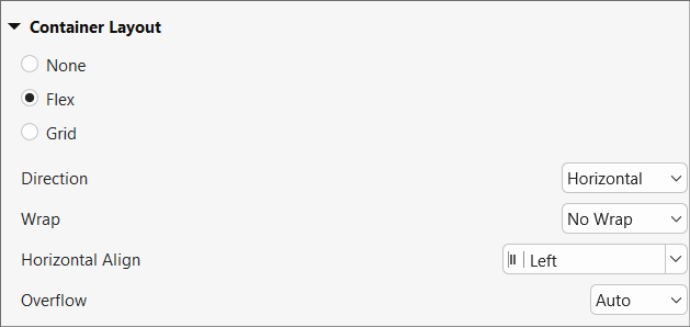

You might try using Flexbox with Auto Overflow to make this work. Feel free to check out the sample project for more details.

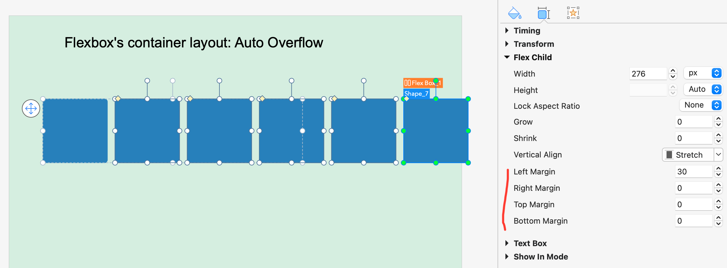

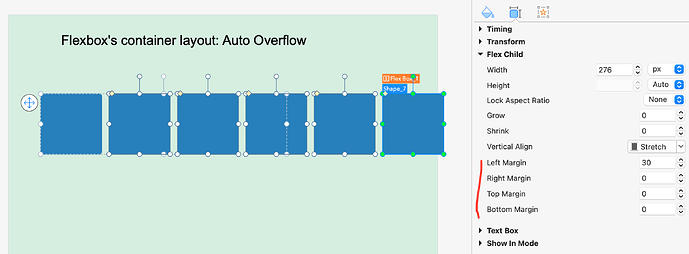

Yes, you can adjust the left and right margins as shown in the image below:

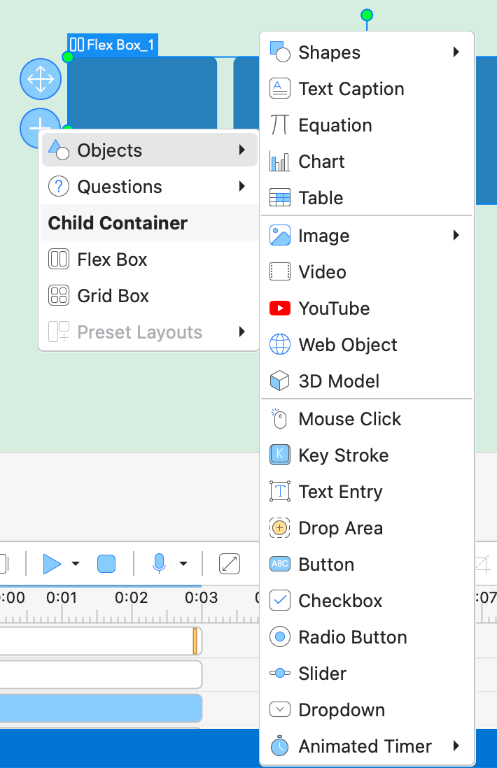

You can also add other objects to the flex box if you’d like:

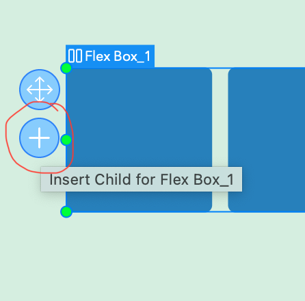

Thank you. For some reason when I was right clicking it was only coming up with the option to add more shapes. I’ll start a new project to see if I have the same issue. Thanks for your thorough response.
Oh, if you’d like to add more shapes or objects (flex children) to your flex box, just click the plus (+) button here; no need to right-click.
Hope this helps.
