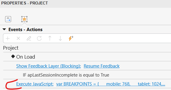

For now, a possible workaround is to add some custom code in the project’s On Load event to adjust the TOC behavior (File > Project > Properties > Interactivity tab of the Properties pane):

Thank you very much for responding. I tried the code you suggested, but the following message appears: “Error parsing the presentation. Check the browser console for more information.”
I will try to check in the browser to see if I can identify this error.
Hi Hang,
I was able to identify that the issue was related to the quotation marks inwindow.addEventListener(‘resize’, applyResponsiveTOC); After replacing them with standard JavaScript quotes, it worked correctly.Thank you very much.
