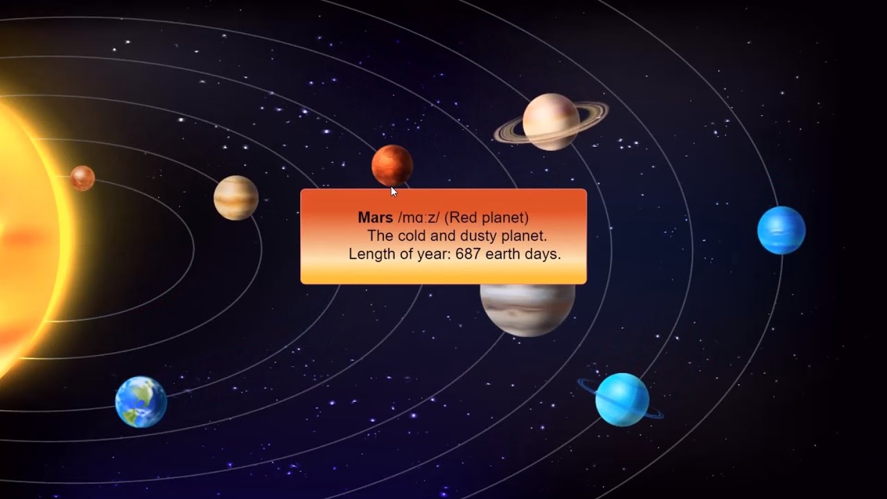

You can take a look at the video sample below for more detail.
In the sample, when you preview, after clicking each shape, a series of actions will take place at once.
To take a closer look at the show-hide flow explanation, please watch from 1:00 to 2:45
Then, add On Click event to the buttons.
And, watch from 6:23 to know how to set up advanced actions. (change On Change event in the video to On Click event like in the sample).

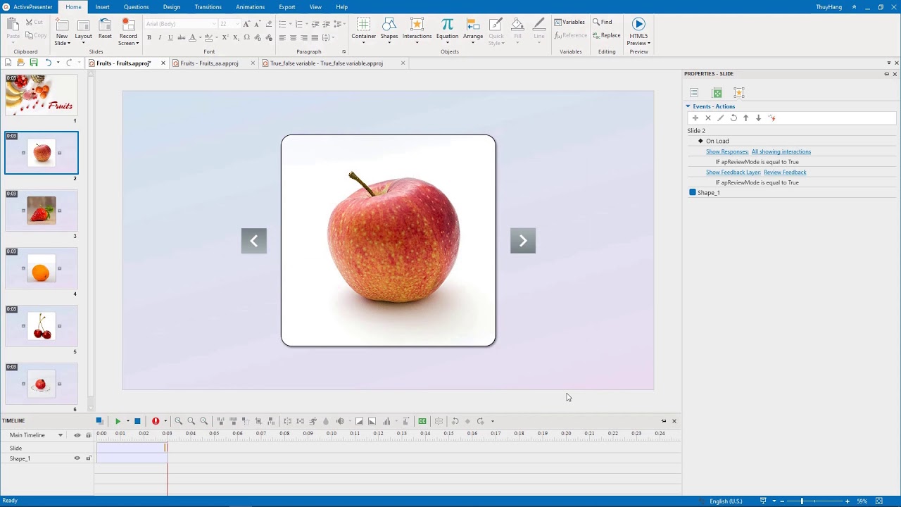

Other samples on how to use Advanced Action can be found below as additional references:
