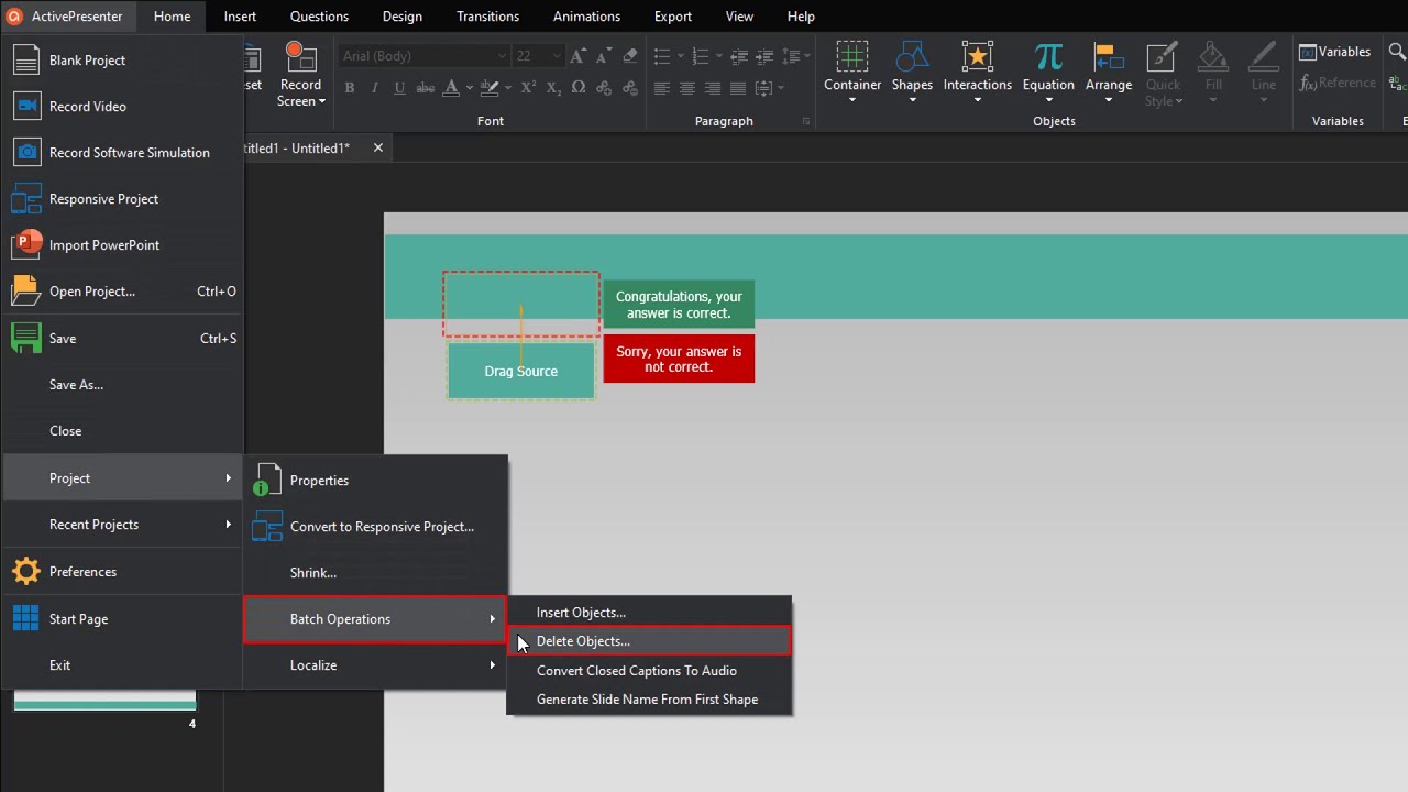

2. After recording.
If you finish recording with multiple slides, follow the steps below:
  • Access the View tab > Object Settings > Shapes/Incorrect Message > Properties pane > deselect the Demonstration mode.
  • Click the ActivePresenter button > Project > Batch Operations > Delete Objects > tick the Shape/Incorrect checkbox > specify the slide you want to delete.
  • Click the ActivePresenter button > Project > Batch Operations > Insert Objects > select Shape from the dropdown. By doing so, the smart annotations will appear when exporting to HTML5. But they won’t be shown in your exported video.
Please refer to this video for more information:
Hope that it helps you.
