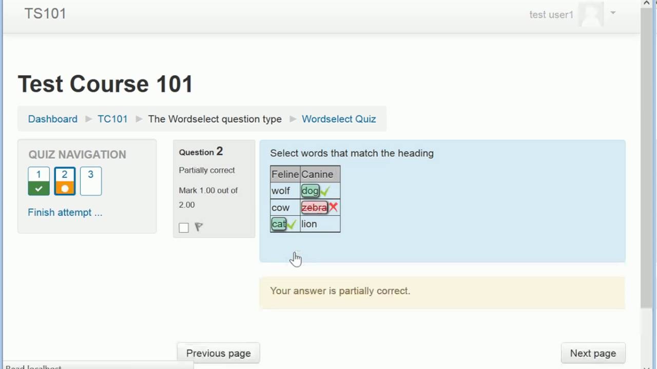

How can I create a question where learners click on misspelled words in a sentence?
I’m creating an English exercise in ActivePresenter where students see a sentence and need to click on the misspelled words to mark them. Looks like:
I’d like to know which question type or interaction is best suited for this task.
Ideally, the learner should be able to click directly on the incorrect words within the sentence (for example, The cat run very fastly yesterday. → “run” and “fastly”).
Is there a built-in question type for this (like “Select Text”) or do I need to simulate it using Hotspot or Multiple Response questions?
If possible, I’d also appreciate any tips or examples on how to set it up efficiently.
Thanks in advance!
