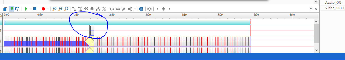

These errors occur when I open and close some files … without distinction.
They do not affect the image or the sound, however, they open windows of constant errors and, later, the sound or image bar are distorted, as in the images.
As you can see, the sound line is linear, not as it should normally be.
When the error occurs, we can watch the video normally, with the sound and normal images. I just did not record it for fear of losing the file.

I am also sending an interesting screen that eventually happens, as if the program read a part of the project, to project on the line.
As you can see, from the screen, the program was mounting the line of the sound graph, then the error occurs, however, nothing happens with the project, it works normally.

In the screen below you can see the open projects and the error that happened:
The error occurred before this cracked portion.
At this point, the project did not reproduce the sound, it was mute. The rest of the project reproduced perfectly.
