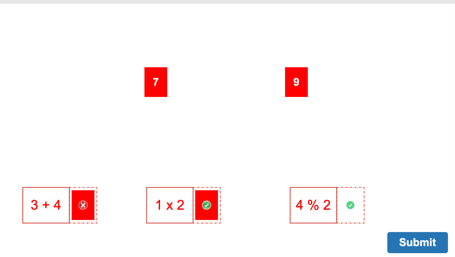

Hello,
I’m sharing a sample project in the attachment. There seems to be an issue in the review mode when some drag-and-drop options are left blank. The review sometimes marks correct answers as wrong and empty answers as correct.
Please open the project and try the scenario shown in the attached screenshot:
  • Give a wrong answer for 3 + 4 =, for example “2”.
  • Give the correct answer for 1 × 2.
  • Leave 4 % 2 blank.
When you click Submit, you’ll notice that even though 4 % 2 is left blank, the review mode marks it as correct.
Is this a known issue with ActivePresenter? How can I fix it?
Thank you.

In this case, one drag source can be dropped into multiple drop targets, and each drop target can accept one of these drag sources. Therefore, multiple scenarios may occur, and it might not have been fixed in the previous update.
We’ll review the issue and get back to you later.

I will upload this project to the LMS for the students at school. I was wondering if there has been any progress on solving the issue? I can’t upload it at the moment because my project is currently faulty.
We don’t have a scheduled update that includes a fix for this issue yet, but you can temporarily resolve it by replacing the player file. Please download it here:
After downloading, paste the file into the following folder to replace the existing one:
C:\Program Files\ATOMI\ActivePresenter\templates\html5\js
You’re an amazing team. Thank you so much for your support.
This issue has been fixed in version 10.1.1. Please go to Help > Check Updates to upgrade to the latest version.
