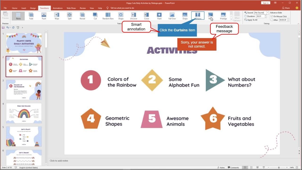

Regarding the mouse click message, please correct me if I misunderstood it.
In case you want to change the feedback messages to all the messages on the slides, you can follow the steps in this quick video tutorial:
