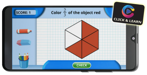

The ClickMaxDistance solves the problem when the user clicks a button but drags it slightly at the same time.
But.. the fix only works when you use a mouse, it doesn’t work when you interact with it on a smartphone.
Here is a Fractions Game that we build with Active Presenter. It works great when I play it on my laptop, but when playing it on my phone, the click still needs to be a pure click, no drag is allowed!
Hi Koen,
In this case, it’s not recommended to modify it so that an off-target tap would also be considered a click. A native HTML button on mobile doesn’t behave that way either. But if you still want to make the change, please take a look at this project:
custom click event.approj (1.6 MB)
Hope this helps!
