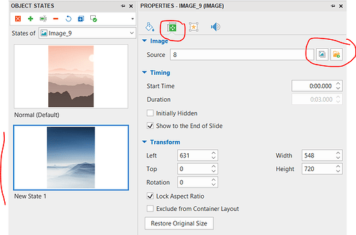

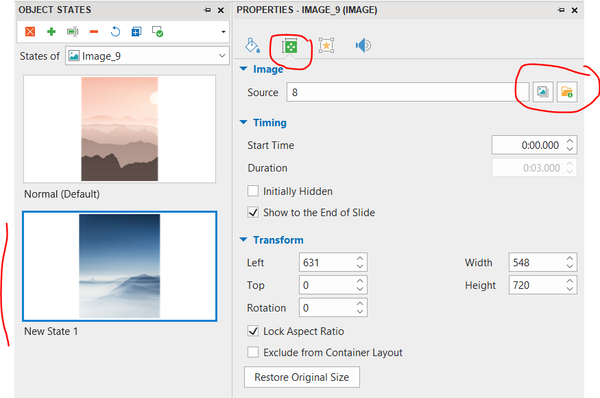

I see that there are two images present but unable to make out how have they been added or what have they been named? Can you please help elaborate? In my case I have approximately 9 images on a single slide. Is the same activity doable when I have 9 images on a single slide?

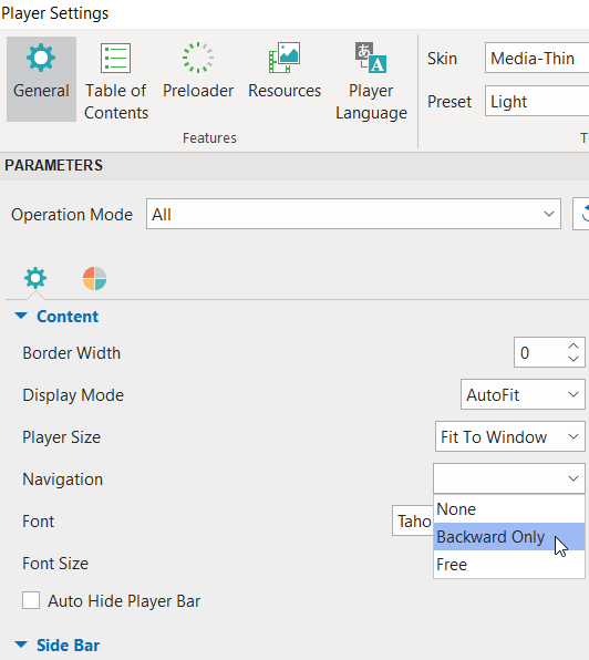

Additionally, is there a way we can create a collapsible TOC? Also, can I lock a specific section of the TOC and make it visible only when the learner completes the previous sections?
Yes, these two images demonstrate an example where clicking on Image_9 changes its object state and simultaneously hides Image_6.
To achieve this, you need to create an additional state for the image using the Object State feature. You can follow this tutorial for guidance:
Then, follow the steps I mentioned earlier to set it up.
This example shows how to handle clicking on one object. If you have 9 objects, you will need to add more event-action pairs to show or hide them accordingly. For more details, see:
Regarding your second question about the Table of Contents (TOC) in ActivePresenter, you can use the default TOC and configure the Navigation option in Player Settings (Export tab > Player Settings) to None or Backward Only as needed.
