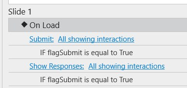

Yes, please find the sample project attached for your reference.
Question1.approj (260 KB)
The steps to create it are as follows:
  1. Create a True/False variable to determine whether the Submit button has been clicked (for example, set it to False in the project).
  2. Add an Adjust Variable action to the Submit button’s On Click event: set that variable to True.
  3. In the On Load event of each slide, add an action.
I really appreciate your help and support with this. Thanks a lot for taking the time to guide me through it.
