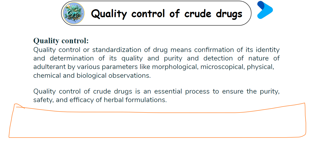

I want ads at the place of orange box
Also Ads get show after at 3/after specific numbers of slide slides which should be full screen and closable
