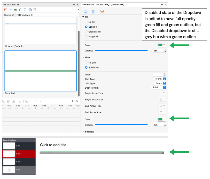

Thank you for your reply @Hoanp. I did that first before trying to create a new state, but it didn’t work. I tried changing both the fill and the line (since the default heavy grey of the Disabled state is what I want to change), but only the line changes (see attached). Is there something I’m missing?
Thanks!
Please select the Dropdown in the Disabled state, then go to the Format tab on the ribbon. From there, you can change the colors of the different Dropdown components, such as Background, Arrow Background, Arrow, Border, and Fill.
Hoa
Ah that’s better - thank you! I think that’s the first time I had to go up into the tab to change properties for an item’s state, so I didn’t think to try it. Thanks for the support @Hoanp :folded_hands:t2:

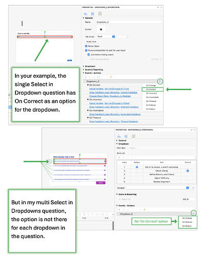

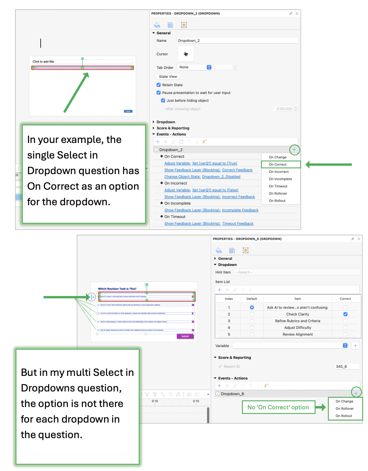

Hi again @Hoanp - I’m sorry to come back with this but I can’t seem to get this to work. The solution you gave me worked for a single Select in Dropdown, but I’m trying to create a Select in Dropdowns (as I mentioned in my original post, I have one Select in Dropdowns with 5 dropdowns). In the file you attached, you have a single SID question on each page, and in Actions-Events > Add Events, there is an option for On Correct, but I don’t see that same option for individual dropdowns in a multi-dropdown question. I’m not sure if that’s clear…see below. Is there something I’m missing?
Thanks!
Thanks for clarifying, and you’re right. My previous example was for separate Select in Dropdown questions, not a single Select in Dropdowns question containing multiple dropdowns.
For a Select in Dropdowns question, individual dropdowns do not have an On Correct event. Instead, you can use JavaScript on the parent question’s On Incorrect event.
First, give each dropdown a unique name in the Timeline pane, then add an Execute JavaScript action to the question’s On Incorrect event:
